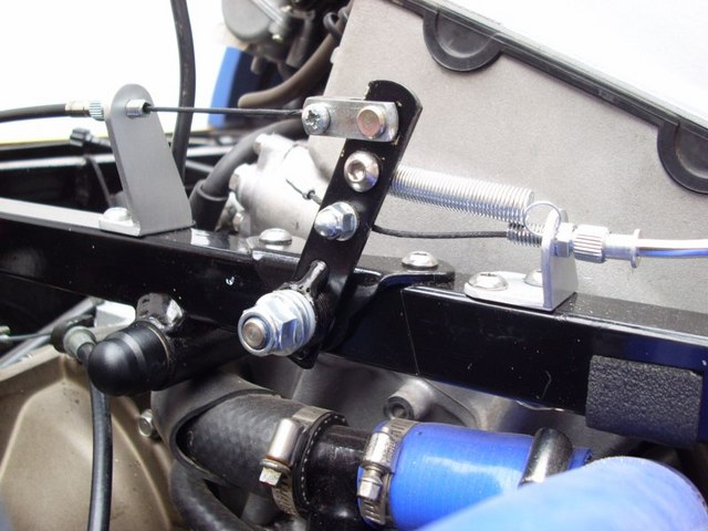

Engine bay, click on photos for more:
Accelerator cable:

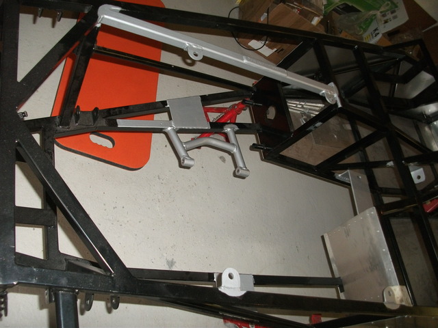

You can see all the mounts I've added here,in silver paint.including the propshaft centre bearing support and the bracket for the cable gear
change
