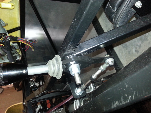

CosKev3
| posted on 13/12/16 at 12:10 PM |
Yeah I welded them in.
Engine end of cable bracket is welded onto the engine cradle,I'll take a pic next time go in garage.

CosKev3
| posted on 13/12/16 at 03:58 PM |
Cable bracket on cradle
How the cable runs
flanders
| posted on 14/12/16 at 08:41 AM |
brilliant, so it looks like it sweeps out from the tunnel to the passenger side, then sweeps back towards the selector via a mount welded onto the
cradle?
Does your cable connect directly to the gear selector lever?
CosKev3
| posted on 14/12/16 at 09:26 AM |
Yeah that's how mine runs,bare in mind mines a R1 engine though so you might need to enter from the opposite side etc depending on how the ZX12
gear selector works.
The MK kit came with a selector arm to bolt onto the selector shaft on the bike box,then cable attaches straight to that.
It's longer than the original bike selector arm.
