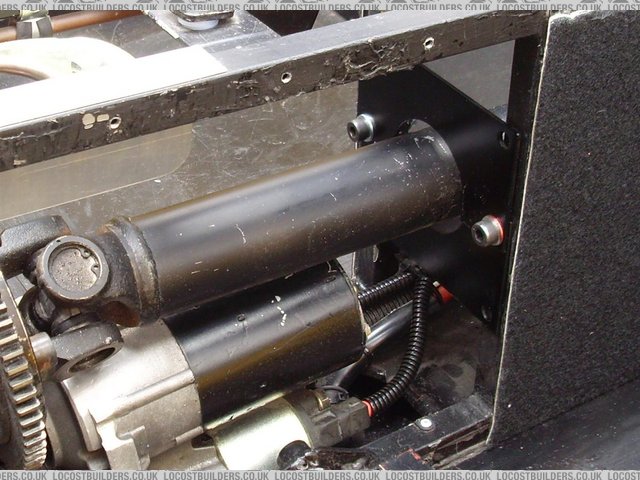

Looks about the same as mine.
  Prop Catcher
But the bottom pivot on the lever is a lot longer than mine. I would make up an extension bracket to lift the lever pivot point.

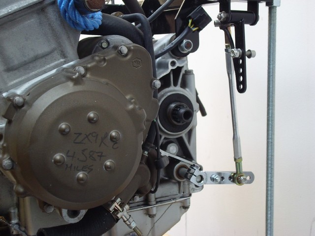

A few I have. I fitted a false tunnel top, about 50mm above the chassis rails. The gear lever was extended the same amount with an ally tube.
  Brake line
  Shiny Gearlever
  Cut out
  tunnel

Banana
| posted on 23/3/17 at 08:16 PM |
That is so tidy.
How does the lever pivot, is that a sleeve/bearing?
40inches
| posted on 23/3/17 at 10:41 PM |
quote: Originally posted by Banana
That is so tidy.
Just a tube over a threaded rod held by circlips. But in hindsight it would have been
easier to make the tube to fit in between the top chassis rails or to fix 2 angle brackets
on top of the chassis rails.
