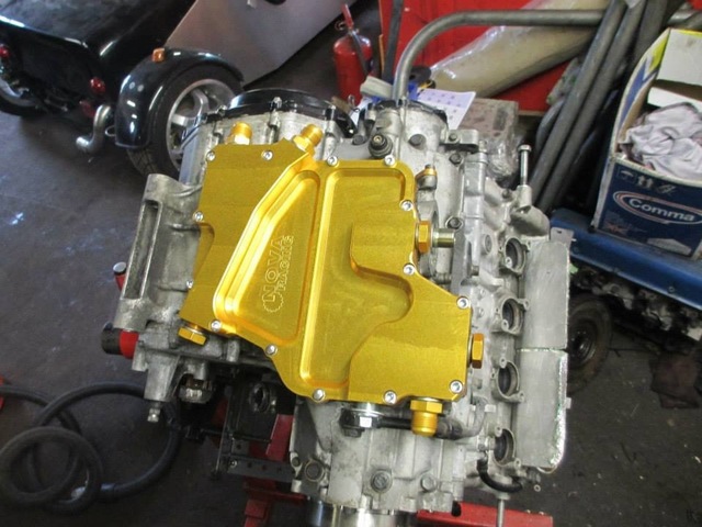

Don't have a photo of my full dry sump set up, just this one that shows the external tank.
My engine has also had the works treatment from Extreme Engines under previous ownership and increased to 1400cc.
None stop smiles while out and about in it!
