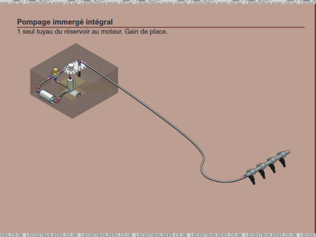

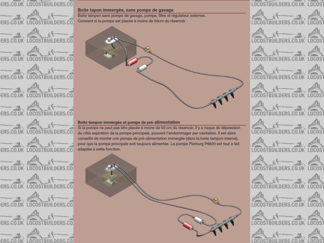

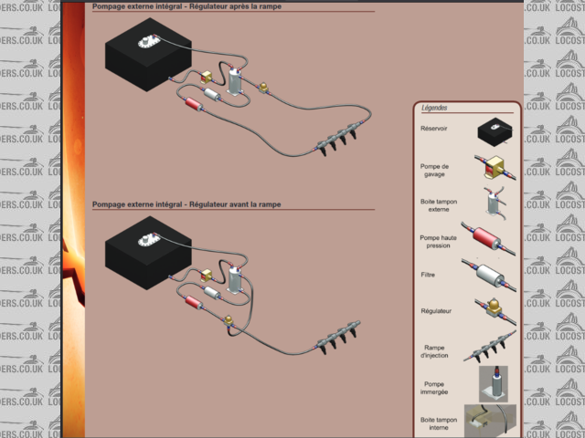

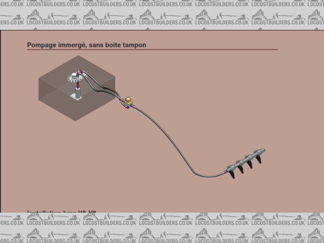

If you have only one line, then it means that return is made in-tank after the reg. See picture 3 below, it should be more or less something like that. Then either you keep this configuration, either you need to install a 3-port regulator on the feed line and install a return line back to the fuel tank.
Here are 3D sketches I made a few years back for the catalogue of a motorosports hydraulic systems company I used to work for. They show different set-ups and where the regulator is placed on the circuit.

Voucht's diagrams are excellent. Only thing I'd add is the last one with the pump at the engine isn't a great way to do it; hp pumps don't like to suck and do should be as close to the tank and as low as possible.
