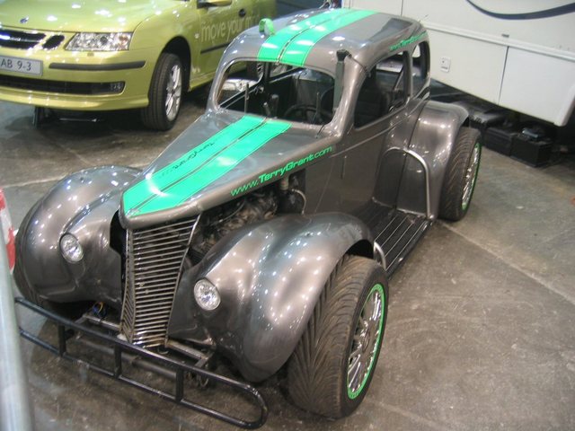

the right way round
RogerM
| posted on 23/2/05 at 08:11 PM |
How are you getting the drive to the wheels???
stevebubs
| posted on 23/2/05 at 08:52 PM |
FJ1300 engine perhaps?

Isn't the FJ the same engine as used in the Legends Racecars?
  Legend Racecar - MPH04
[Edited on 24/2/05 by stevebubs]

Fred W B
| posted on 25/2/05 at 05:47 AM |
going back to the picture of the blue car, can they not get the engine any further back? Seems very far forward to me
