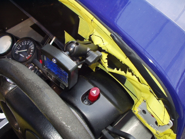

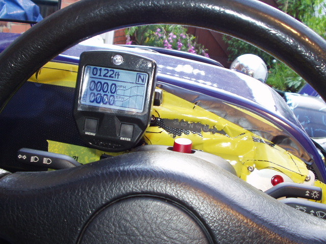

| posted on 6/7/05 at 09:19 PM |
Fitted and wired up my VR2 Veypor and Bright 6.
Photos as requested by GeoffB.
For scale, wide view of dash, with a standard 80mm speedo placed along side to give idea of size of Vr2 Display.
  VR2 80mm
Close up of VR2 Display behind Sierra Wheel. I have located it so that it is inside the Sierra wheel, but could be moved up, in case I ever change to
a smaller wheel. Say after an important government test.
  VR2 Close
Final shot from above showing mounting arm, although you could fix it flush to dash if you wanted. Should deflect for SVA purposes.
  Mounting Ball
HTH Mike
