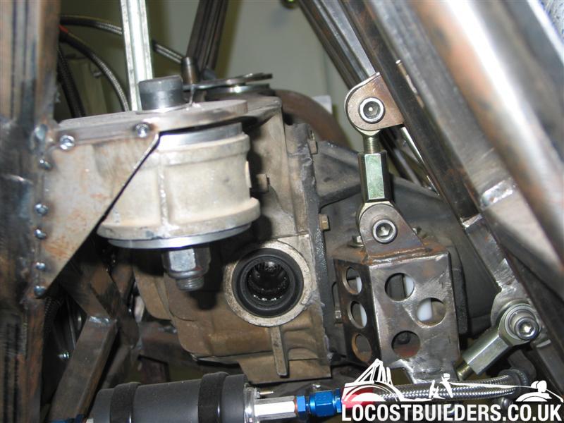

Tralfaz
| posted on 5/10/05 at 11:42 PM |
Kurt,
If I understand your thinking, you wont be able to install a sprocket any larger than 5" in diameter without major modifications to the mounting
'ears' that the unit hangs from.
Here is a photo of mine.
Regards,
Brian
