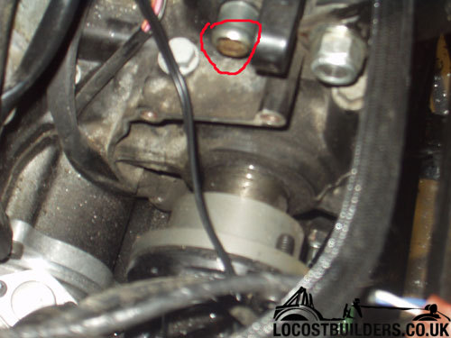

Cheers mate and seeing that your being the semaritan could you identify this :
Located just above the prop it looked like it had some kinda hose on it but i cant seem to find anything in the manuel maybe its nothing but no harm
in asking.

| posted on 30/8/06 at 09:48 PM |
in asking.
Crankcase breather. Stick some hose on it and a small K&N filter or similar.
