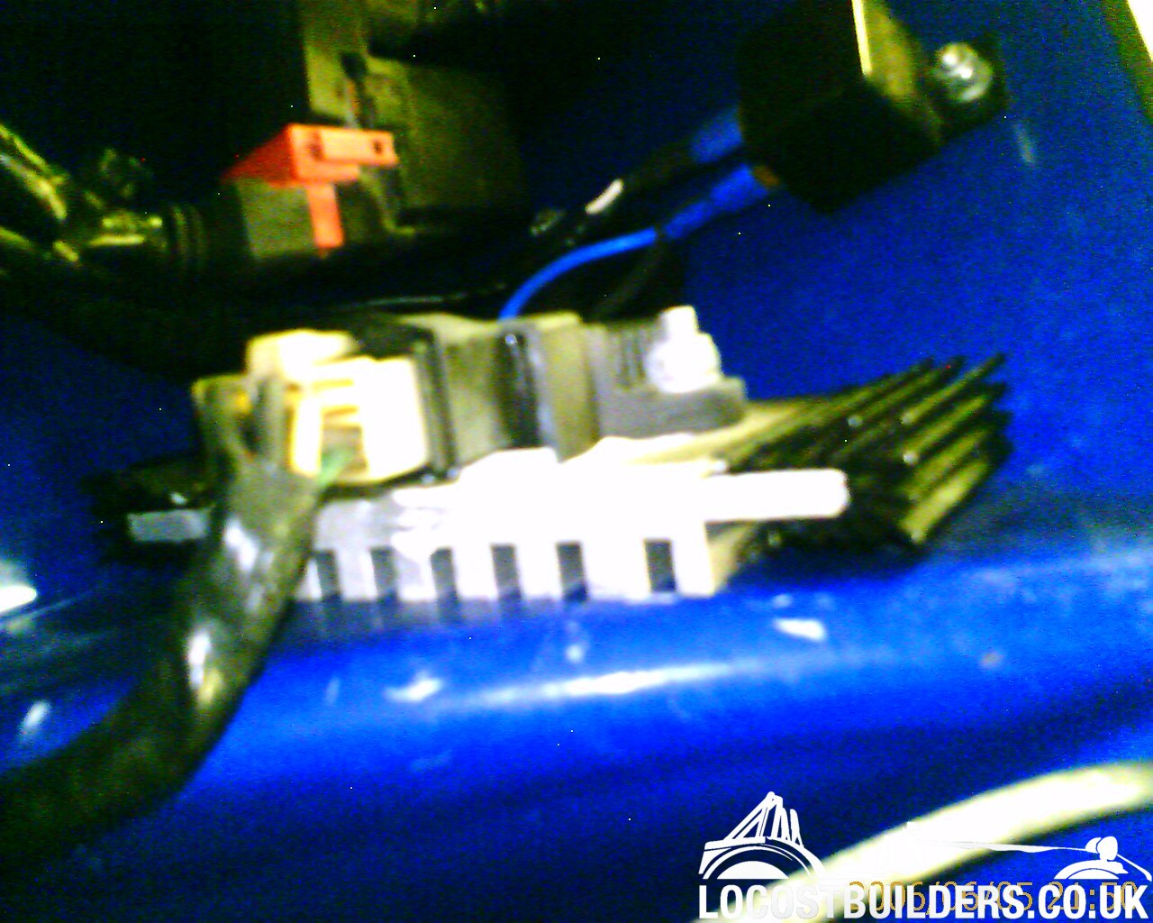

watsonpj
posted on 16/9/06 at 06:16 PM Reply With Quote
Make sure it has a really good heatsink I had one go and swapped to another one which a bike shop recommended, which has morer cooling fins on it. I also bolted it to a block of alloy and attached some heatsink cooling fins on that. Sorry the pictures so big
[img]http://[/img]
Its lasted 2yrs now.
