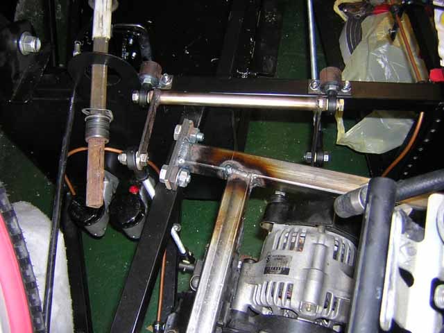

zxrlocost
| posted on 29/12/06 at 06:54 PM |
or paddle shift it like me with an aprilia rs250 brake lever bolted to my top engine mount and rose joints with alloy threaded bar
that was with an r1 engine
couple of pics in archive

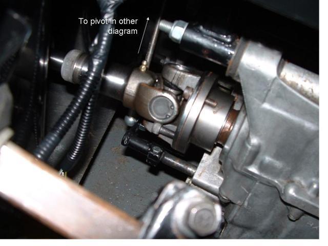

esn163
| posted on 29/12/06 at 06:59 PM |
Hi,
heres our MAC1 linkage on our blade
  linkage1
and
  linkage2
Ed

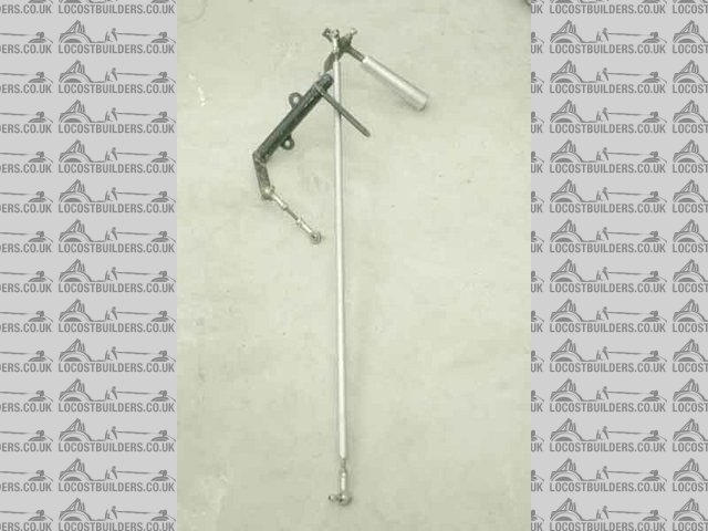

worX
| posted on 29/12/06 at 07:19 PM |
photos
Thanks Ed,
Your photees have been the (only) closest so far, but from what I can make out, my mount is different to yours, mine being on the engine cradle
itself, virtually above the gear selector rod itself..
jeez, what I wouldn't give for a build manual for this car!!!!!
Steve.
esn163
| posted on 29/12/06 at 07:34 PM |
i think the worx already has the bracket labeled in the top pic welded into the chassis because colin had to make this up specially to fit the indy -
this is probably why it is slightly different but will probably be a similar system that it is designed to fit
HTH

worX
| posted on 29/12/06 at 07:41 PM |
Bracket
Yes, you are partly right (I think) - I think that "the bracket" in question is on my engine cradle, but when I piece the parts together
in what seems like the obvious way, the ali rod between pivot in "the bracket" and selector rod is 90 degrees out, and just doesn't
make sense???

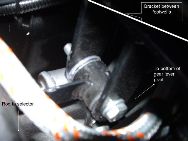

Wadders
Sorry, not very mac1 or blade specific, but this is how i did mine ( ST ZX9 ), might give you some ideas.

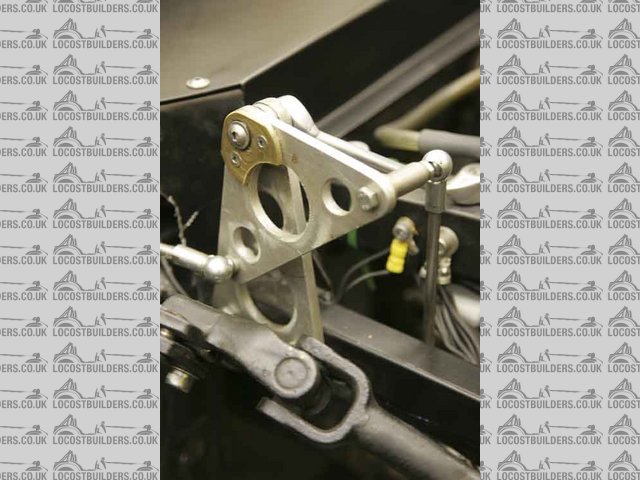

rayward
| posted on 29/12/06 at 07:57 PM |
  gearlink1
  gearlink2
  gearlink3
  gearlink4

| posted on 29/12/06 at 08:13 PM |
Rayward
Thanks for photos, really clear and mid build, but now I'm thinking that I should of just asked for photos of JUST Mac#1 worX cars, as only
photos of them will help I think as I want to use what I already have. I would take a photo, but it's a bit wet out there for my camera!,
showing you what I'm working with. To be honest I think that it would work the way I have it if I could turn the "rose joint" type
linkages 90 degrees as then it (should) all fit together IMO...
thanks to you guys that sent in photos of the releveant images...
As before if anyone has images of gear linkages of specifically worx cars with the pivot bracket on the engine cradle then please get them on!!!
Steve.

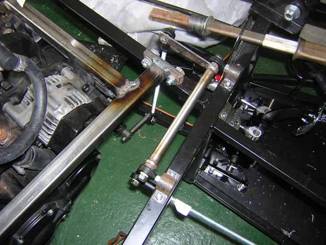

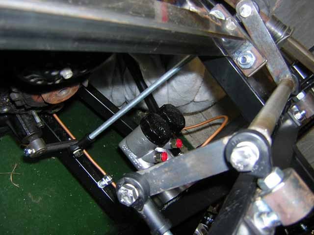

zxrlocost
| posted on 29/12/06 at 08:15 PM |
worX have you looked in my archive and read my comments
my pivot was above the gear selector shaft
slightly bent so at an angle

worX
| posted on 29/12/06 at 08:20 PM |
ZXR
I actually read one of your previous posts with pics of your linkage in it and it isn't similar enough to me for it to be relevant to this stage
in my build, I just checked again and it's not the same as the MAC#1 linkage, which I already have, and therefore no use to me at this time,
thanks anyway, I appreciate the advice offered...
cheers,
Steve.

worX
| posted on 29/12/06 at 08:27 PM |
ZXR and All
check back in 2 mins mate, I'll just take some pics...
cheers

worX
| posted on 29/12/06 at 08:38 PM |
My photos...
please click below for a view of my photos, I thought it would be easier to upload large images here rather than in this post
http://www.p4nts.co.uk/help
