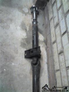

cheers, that sounds about right. Is that prop from MK? dont suppose you have a pic of it do you? heres a pic of the one im looking at buying, its been made professionally by someone for Playskool, but he wants £200 for it, its only 2 weeks old in use but 2yrs in his garage. I dont think it looks like a trt prop, can anyone confirm this? if its not then ill go with mk as its going to be half the price!
Pic here -
http://avatars.gentlyhosting.co.uk/9791.jpeg
damn link isnt working! its here on the wesfield forum...
http://boardroom.wscc.co.uk/cgi-bin/ikonboard.cgi?act=ST;f=8;t=48549

Yes mine is a MK prop,Ive not got any pictures,will take one and load it up later,if that one he's selling is trt its worth £200,I am taking mine up to dunning and fairbank tomorrow to have a trt fitted to mine,they charge about £150 for this,with a new centre bearing,and balanced.
Just make sure your measurement is correct,as 1/8" too long or short and its not a lot of good to you,you may be better getting MK to make one for you to your correct size.
Toady1
posted on 25/1/07 at 07:38 PM Reply With Quote
mmm, im converting my car from cec to bec so the extra inch length wont be too much of an issue as ill just put the engine forward more, and an extra inch shouldnt make much difference. I asked him if it was a trt one and he had no idea what i was talking about?
