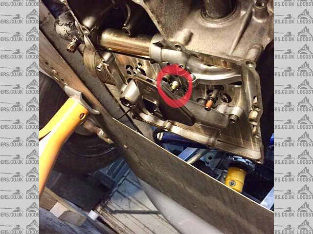

Sorry chaps, I now understand about the water relief tube, there’s another pipe that’s secured by a little bracket with a small Allen bolt. When I
first removed it it was a snug fit, now it drops out if the retaining bolts not in.
Does anyone know if there is a seal or onring for this and what the tube actually does?
Is described as an oil delivery tube by yamaha

Furyjim
| posted on 16/1/18 at 10:06 PM |
[img]http://
  R1 sump pipe
