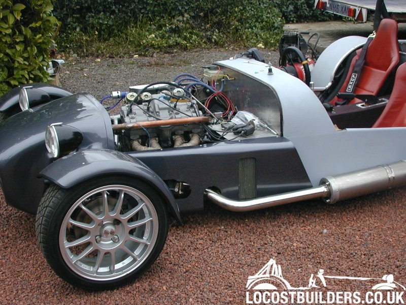

Well after a few weekends and half term spent on the car its starting to look like my on-the-road-for-summer ideas might just come good....famous last words of course...
Got the paint on and gingerly cut the side panel for the oil cooler - which was a 'moment' but it looks pretty straight although the cooler is very tight to the insides of the side panel and will need a little scoop if its gonna get any useful air flow through it.
Scavenge pump is in place and just needs the hose I ordered off ebay ages ago to arrive and I can finally plumb it in properly.
Bonnet is this weekends job.....
If any of you North East builders fancy an SVA pi$$-up / edge trim party you are all welcome round my place when the time comes - cucumber sandwiches and afternoon tea provided of course!

i see you have a dump valve fitted on the other side of the engine there, i put one on my engine the other day, why did you fit it, to prolong the life of the turbo, less turbo lag, or was it for the noise, do you think it makes a differance ?
graham
jambojeef
posted on 8/3/07 at 11:53 PM Reply With Quote
I put it in as more a safety valve I suppose - I had read a couple of books saying that there can be pressure spikes of around 50psi in between gear changes and things and so for the sake of a litle modification to the plenum I thought if it saves some bent throttle spindles its maybe worth it.
Dunno about the noise yet - guess I'll find that out on the way to the SVA station!
