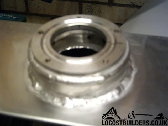

I embedded the original R1 injection pump into my fuel tank. Works a treat. Pumps can be had for around £20 on e-bay. Only issue is getting tank fabricated to take the pump in the first place.

I agree with Paul above,if you not had your tank made yet,get the fuel pump R1 pump mounted in the tank,then you fuel level indicator will work aswell,Martin at mk did mine for the zx10

Guys - great idea on using the original bike pump. I was planning on doing this originally but only have about 50mm below the tank. I ended up with this ! That's the standard Bosch High pressure pump btw.
I'm seriously thinking of getting the tank remade with the bike pump (got a blackbird injection one on the shelf) mounted up inside it to save a bit of weight and to simplify the system.
