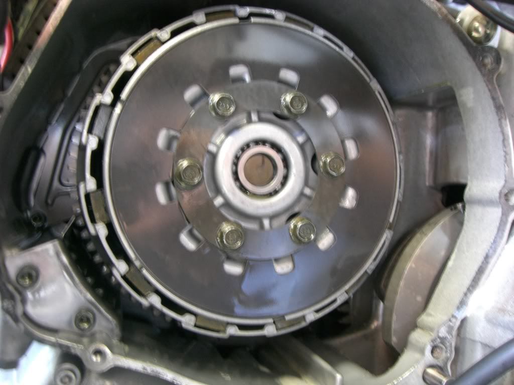

Just as I thought I was going to drive the car under its own steam for the first time, I realised I lost all drive. I have an Yamaha FJR1300 with hydraulic clutch. I must have over travelled the clutch. I took off the clutch cover and can see that the friction plates are loose - I can jiggle them a bit. So it looks like something jammed inside.
Anyone seen this happen before (I don't have a hard stop, but will soon)? Is there an easy way of freeing it up, or does the whole clutch need to be dis-assembled?

Does the FJR have a diaphragm spring like the (pre 2004) R1s etc, as opposed to the more conventional 5 or 6 coil springs? If so Id imagine you could just undo the cover plate to free it up, or even put a bit of force on the plate to pop it back over-centre?

Here is a picture of the clutch, it is a diaphragm type...
I looked at the manual, and to change the clutch it mentions removing the rear counter balance shaft. I am hoping I can just loosen the spring plate and take it apart......

All good, took off the diaghragm plate and set it all back up again.
