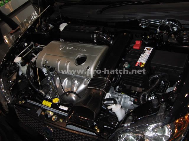

I am not sure how the price compares but I used the top radiator hose from a Proton with the Campro engine for my top and bottom hoses. It reduces
from the Polo radiator to Yamaha pipes (actually 2mm bigger on engine side but fits ok with clamp) and has a nice "s" shape that fit my
car perfectly. I agree that silicone hoses look great but this may save you a bit of cash for now.
You can see the top hose in this pic. I am not sure of your UK models.
