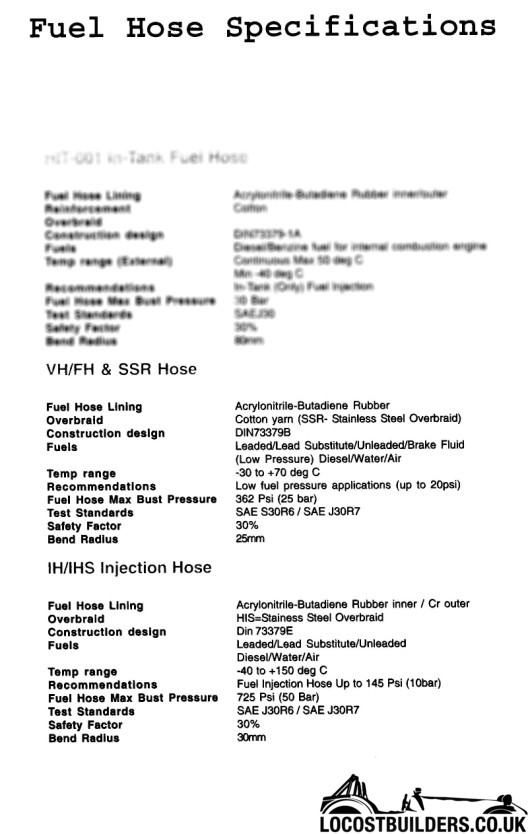

Thinking of running stainless steel overbraided fuel hose through the car and have been sent a data sheet. Its in my archive as i can't get it to load up.... Do we think the SVA man will be happy with this?

Still need an opinion or two on whether thus data sheet will be good enough though.
