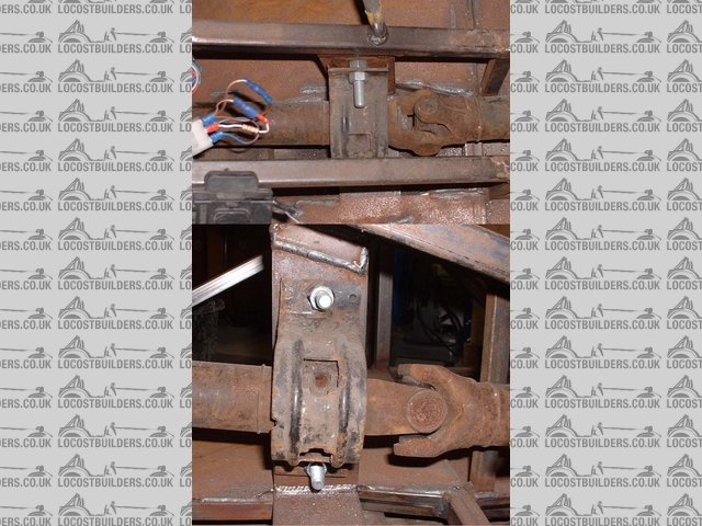

| posted on 26/7/07 at 05:00 PM |
Can't you put a plate in and mount the prop bearing on the side of the tunnel instead of the floor? It would give you more options for changing
the angle by using shims or nuts either side of the bearing support. Here's my temporary one to get the angles etc., excuse the rust
