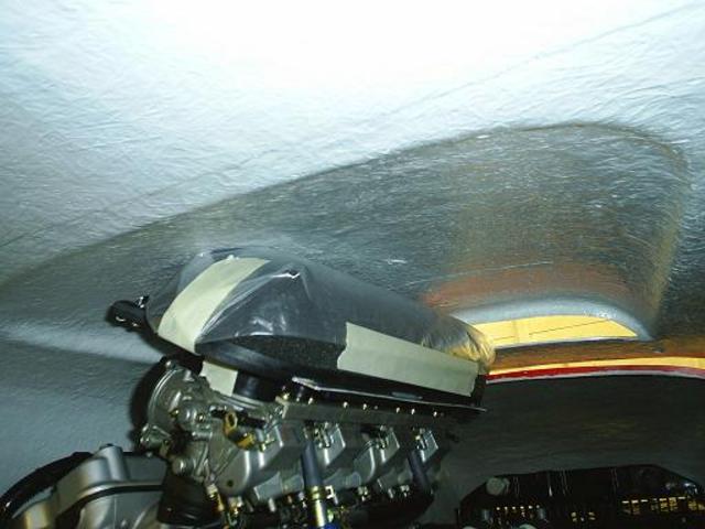

Dont know if this is to late, but make sure you keep it well back towards the battery tray, if you dont, the filter hits the begining of the bonnet
scoop, like mine.

oh dear!! Already put it on now Will check for clearance now.
Oh CR*P! Bonnet sits on top of the whole filter!!!!! And i have a bulge! Do i just force the bonnet down on it or do i have to cut a big hole in the
scoop?

not good!
Looks like i will be cutting a big hole!

It would look tidier if you cut the sides of the scoop and raise it a couple of inches.

It might fit if i use a pipercross box filter instead of a domed one as they are alot thinner.
Anyone want to buy a new domed pipercross filter?
