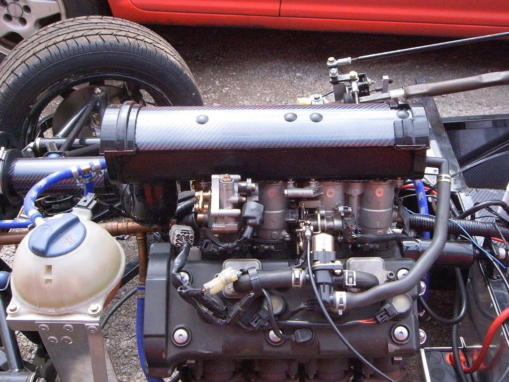

With the fuel rail one side and the secondary butterflies servo motor the other, it looks very tight for fitting an air filter in there without a spacer. Anyone else come across this at all??
Paul

adithorp
posted on 18/8/07 at 10:49 AM Reply With Quote
It is. I've made up an air box to a remote filter. I'm about to make version 2 which will be a bit lower to fit under the bonnet.
I'll post pictures later (not at home).
Adrian
adithorp
posted on 18/8/07 at 06:33 PM Reply With Quote
Heres the picture
http://i189.photobucket.com/albums/z282/adrianthorp/fury007.jpg
Adrian
Paul TigerB6
posted on 18/8/07 at 07:34 PM Reply With Quote
Looks good - wish i had the space to do something similar myself!! From the measurements i have been given by another Tiger owner, with my sump 1 inch below the chassis rail the throttle bodies are half an inch under the lowest point of the bonnet and the servo will stick up out of the bonnet!!!
adithorp
posted on 18/8/07 at 08:58 PM Reply With Quote
Thats my problem as well. Hence version 2 which will be the same height as the secondary throttle assembly. It'll also have an inlet on both ends to allow more air in and feed the throttles more evenly.
I'll make it this week and take pictures as I go.
