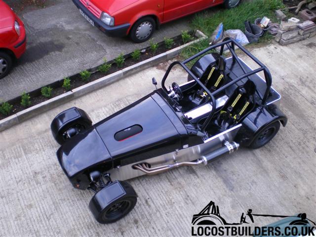

Car Road Legal From Today (F#ck me)
And I drove for aboout 5 hours!
And my three passaengers (at different times), all said the same two words, the last one being hell.
Jesus it's fast when you open it up.
Bye bye M3, RS4 and anything else that tried!
Few teething problems with fuses blowing and getting used to the biting point and paddle shift.
What's the best thing to do when you get to traffic lights and junctions, it was always a frantic hand shuffle looking for 1st for me and sometimes got stuck in neutral.
Well chuffed though - never been in anything so fast (and frantic).
Pat...

That looks the nuts
Bare, basic, neat - quick.
And the wheels are the right size too

Glad its on the road and all running well Pat
Coming up to junctions you just have to try and remember to change down as you're coming to a halt. If you get stuck in neutral and can't select first, just bring the clutch up and back down, then it will go in. If you get stuck in a high gear after stopping, just drag the clutch for a split second which will move the dogs enough for them to engage and allow you to change down.
All blades and most bike engines do this BTW, not just the one I sold you!

That looks to be a very nice car you've built there, Pat.
Well done.
So, how does it compare to your old pinto powered Avon?
Is it truly faster or is it a combination of not having driven a 'seven' for a while and the frantic nature of the engine making it seem faster?
Andy.

Hi All,
Don't worry Chris - never doubted you or the engine and anything that happens now in will be my own doing!
Andrew - it is seriously quick and would leave my Avon for dead.
100 comes very quickly indeed with my 3.54 diff and 13" wheels.
It's a truly amazing experience.
You can trundle around like a car at 30 in 6th gear, drop into 3rd and boot it and all hell brakes loose.
Got Elvington Airfield booked for the 1st September already!
Pat...
