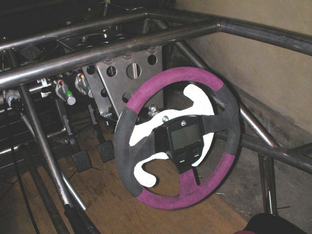

I am nearly ready to weld up everything and strip the chassis of parts. Ignore the paper paddleshift!

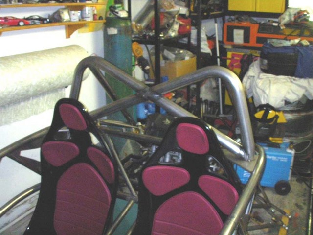

One question, any reason you didn't bring the rollbar to meet the outer chassis rails? Looks like a possible weak spot without gussetting below
- unless that plate is particulary thick...
James
[Edited on 18/1/08 by cloudy]
nitram38
| posted on 18/1/08 at 07:31 PM |
The plate has a folded front edge and is pretty strong. The main reason for bringing the rollbar forward is to allow the seatbelts to fit and
unfortunately the MK roll bar is not quite as wide as the car. So it will not end up right on the point the two rails meet anyway.
I trust it and that is all that matters

quote: Originally posted by Confused but excited.
Starting to look really impressive.
I see you now have the full set of Starett cutters.
I have one better than that.......a mate with access to a cnc machine!
I only have to mount the gearshift cable bracket and make a plate for the fuel filler, plus complete my shock mounts ( these are pretty easy to do)
and then it is engine out and full weld up.
I will still need to construct a floor pan. I will make it in timber then take a fibreglass mold, so still plenty to do.
(The square hole in the column top plate is for the brake resevour and the scuttle panel over this will be flat but have two smoked bubble screens
mounted on it. There will be a cut out under the bubble so you can see the resevours)
[Edited on 18/1/2008 by nitram38]
