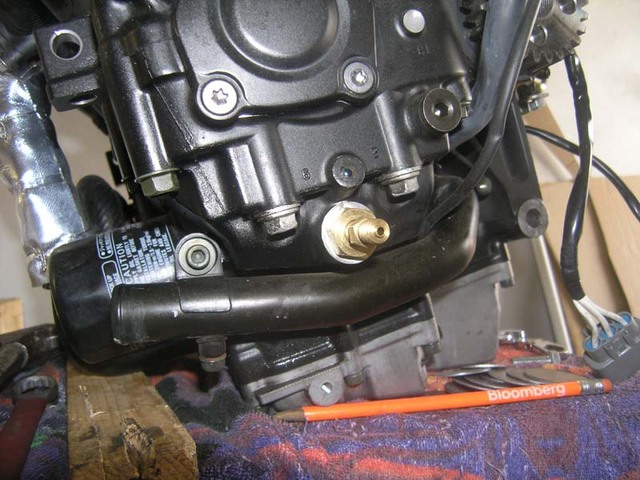

While I wait for my fuel tank so that I can weld on the final brackets on my chassis, I have done some R1 mods, ready for the evential re-planting in the chassis.
I have used the main oil gallery for my capillary gauge take off.
I am using the Durite adapter as recommended on here. The mail adapter sticking out screws into the durite one. I may remove it if I can get a male braided oil line with a 90 degree bend.
The pull clutch bracket was really simple as basically it is a flat plate which bolts on the existing gearbox casing.
If anyone else does this, remember to fit washers between the plate and the case as there is a recess for the bolts.
The lever on the clutch arm has been added to and extended so that I should get full clutch pedal travel instead of a short pedal with a stop.
I have also welded a 3/8" bsp boss into the top water outlet (before thermostat), courtesey of paddler20 (thanks) which is at the platers.
I am just heading off there in a minute to drop this plate in as well !!!!!!

posted on 22/4/08 at 11:30 AM Reply With Quote
what's that doing there?! go and put it back on the cupboard door and use a proper nut & bolt
[Edited on 22/4/08 by Mr Whippy] Rescued attachment bike engine.jpg

Coose
posted on 22/4/08 at 11:56 AM Reply With Quote
I was wondering that too!
And where again did you get your motor from?
Spin 'er off Well...
nitram38
posted on 22/4/08 at 12:01 PM Reply With Quote
It was the only M6 available at the time!
tegwin
posted on 22/4/08 at 12:04 PM Reply With Quote
Where did you get your cluch cyl from? looks like a smart solution!

nitram38
posted on 22/4/08 at 12:27 PM Reply With Quote
Can't remember where, but it is a wilwood pull slave.
nitram38
posted on 22/4/08 at 09:49 PM Reply With Quote
Here are the dimensions for the modified clutch lever if you want to go this route.
The extra long arm is welded on so that when you take up the freeplay it is at the correct angle for the slave.
The original arm is left on as it still used for the return spring. Rescued attachment clutch slave setup.jpg
