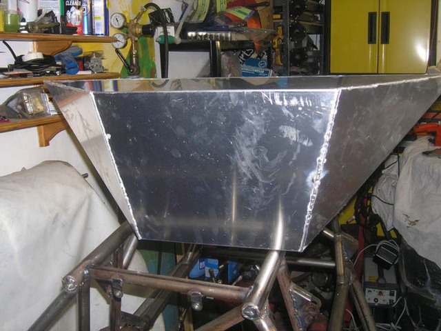

After 6 weeks I finally got my basic fuel tank sorted out.

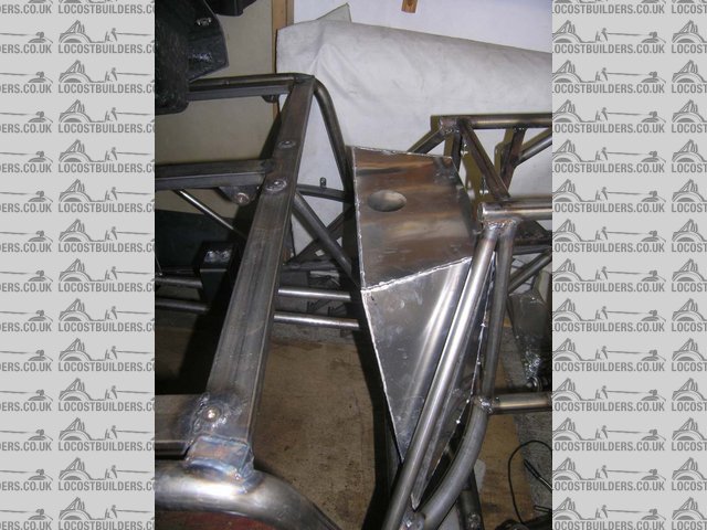

It is an unusual shape to fit my chassis.
It is short of the bottom of the car because of the fuel pump sticking out and the angles are to allow for the floor tub and chassis rails. (the
welding needs re-doing as it looks rough, but I don't have to pay for it.) There is the fuel pump flange still to be added along with a 2"
filler and two 8mm fuel pipes.
After it is sorted, it will be polished/anodised in this colour:
To handle it is quite large, but filling it with water told a different story.
It's capacity is only 6 gallons or 27 litres.
