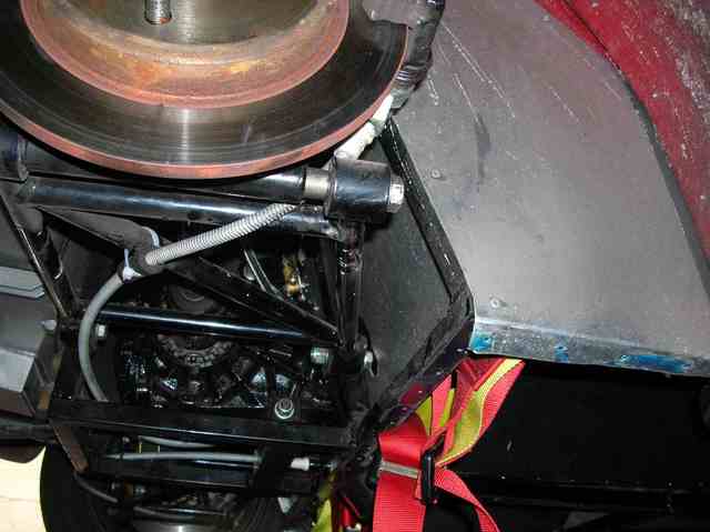

I'm the Italian owner of a 2nd hand Raw Striker.
I need to know what diff is on my car since I want to install a lsd unit...I thought it was an Escort english axle but I know that unit mounts 16 or
22 teeth half shaft while my shafts have 26 teeth...Could it be a Sierra 7 inch?

motobaleno
| posted on 21/5/10 at 04:45 PM |
pict 1 (hope)

| posted on 21/5/10 at 08:19 PM |
You have a Sierra diff.
ratios are 3.14 (very rare), 3.38 (rare), 3.62 (common) and 3.92 (common).
IIRC LSDs are 3.62 generally.
Worth checking as a change of ratio will alter acceleration and top speed
