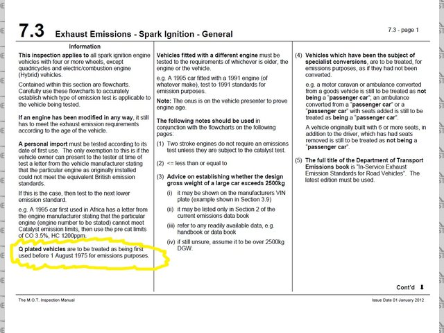

posted on 10/7/14 at 09:22 AM Reply With Quote
Originally posted by loggyboy
Mot Manual specfically states than Qs should be tested for visable smoke only. If a tester doesnt then it should be queried.
Not the best photo, but you are certainly correct. Regardless of the flow charts and the IVA man, the MOT handbook (issue date April 2013) says Q plates are visible smoke only. Pretty Awesome!

posted on 10/7/14 at 11:56 AM Reply With Quote
Are you sure that is right about Q plates. I have no information to suggest it isn't, just that it doesn't make sense.
My car was SVAd with a 1990 Sierra CVH engine and so had to pass emissions based on that engine [3.5% CO / 1200ppm HC].
When went for registration there was a question over whether I got an age related plate or a Q. I ended up with an age related reg. and so have to pass the above emissions at MOT time.
If they had given me a Q plate would I only have to pass a smoke test?

mcerd1
posted on 10/7/14 at 12:40 PM Reply With Quote
That's right
as I remember they changed the MOT manuals wording a wee while back to simplify/clarify the rules for Q plates
