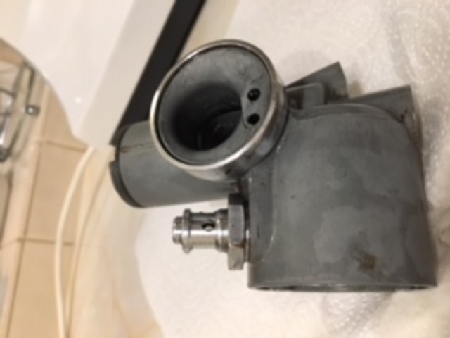

ReMan
| posted on 16/7/18 at 11:31 PM |
Thanks for this tips and ideas guys.
I started last night after using some spray carb cleaner and a brush but wasn't that impressed. OGK for dissolving some thick gum, but not
really cleaning.
So i chucked it in a bowl with a washing powder tablet and fished it out this evening, gate it a bit of a scrub with a toothbrush/stiff brush and its
not come up bad.
I feel it needs a bit of something on the outside to give it a bit of zing though?
Like blasting but cheaper! Wondered about some sort of long stifff bristled brush in a drill to get into the nooks?
I dont want to polish it, just sort of "cut" the surface a bit.....

steve m
| posted on 17/7/18 at 07:42 AM |
As long as theres no rubber left in the carb, leaving it submerged in thinners will clean out any crud,
also a good blow through with an air gun
steve

MikeR
| posted on 17/7/18 at 01:28 PM |
If you want to clean the surface to pretty it up if be looking at a fine grade wire wool / wire brush. The drill brush may work but I've never
find them very effective.
However id expect the tarnished look to return quickly if you did nothing to protect the finish.

ReMan
If you have access to a compressor, you can make a homemade soda blaster for very little money.
Results are really good.
Regards
Angel Acevedo
ReMan
| posted on 20/7/18 at 02:47 PM |
Yes I have one, thjough its only 25L , but maybe for something carb size it would work.
I'll have a look on you tube at rigging one up
