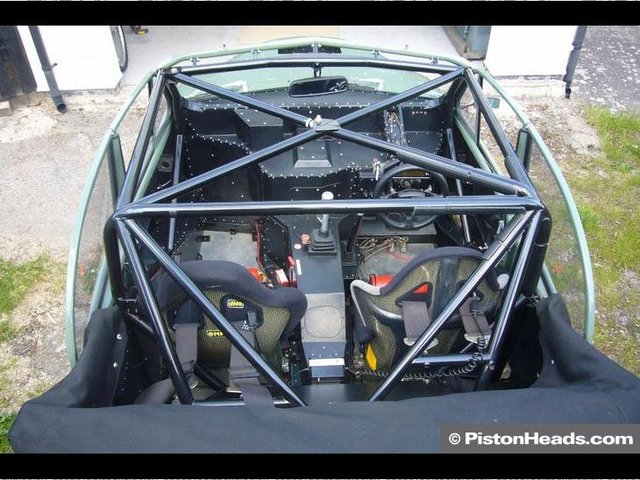

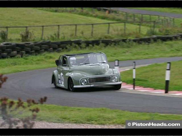

I thought this was very cool when it was posted! Just needs a decent bike motor...
http://www.pistonheads.com/news/default.asp?storyId=25968
[Edited on 13/3/13 by Pat_T]
