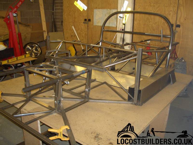

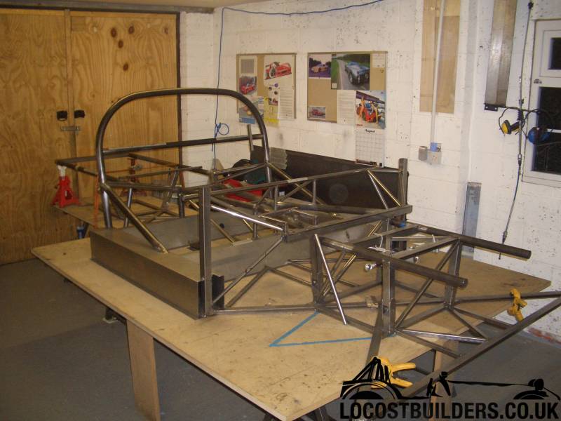

I'm about mid way through making the chassis, I still have some bracing at the front to do and have most of the rear to do..... but here is a pic
I took tonight.
[Edited on 1/9/05 by andygtt]
