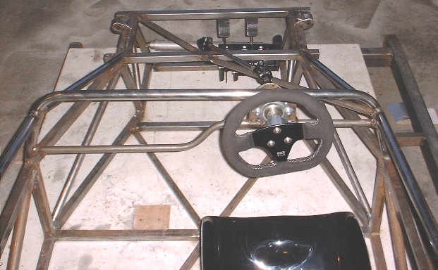

You can add me to this list as well!!
Stagger V8
Audi 4.2 V8
Based on the 1938 Auto Union Type C
