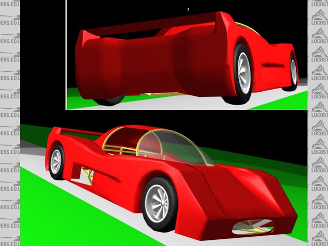

BasOlij
posted on 9/1/03 at 07:31 PM |
Looking good!
Hey Everyone,
it's starting to look good! I think I'll stick with this design! Just need to start detailing it.
Will start working on a nice website for it soon since I am starting to bloat this thread with pictures:-)
Tell me what you think so far?

| posted on 9/1/03 at 07:59 PM |
So it has a roof again...
I think it lloks pretty good, but I'd either lower the roof or make the wasteline higher. Just an idea...
BasOlij
| posted on 9/1/03 at 09:15 PM |
I am thinking about raising the back a bit. The actual top I am not going to finish until I have a good idea how the size in real life is. The roof
may be higher then needed but it might also be that the roof is to low.
Not sure what the best way will be to test it. I am thinking about building part of the car from wood 1:1 scale to find out. They had a sale on wood
the other day at Gamma so it should be cheap enough to do. Then I can deside if it is to high or to low. Also the wood frame I could complete the body
work on and use it as a counter mold.
But dunne know yet, seems like an awfull lot of extra work....

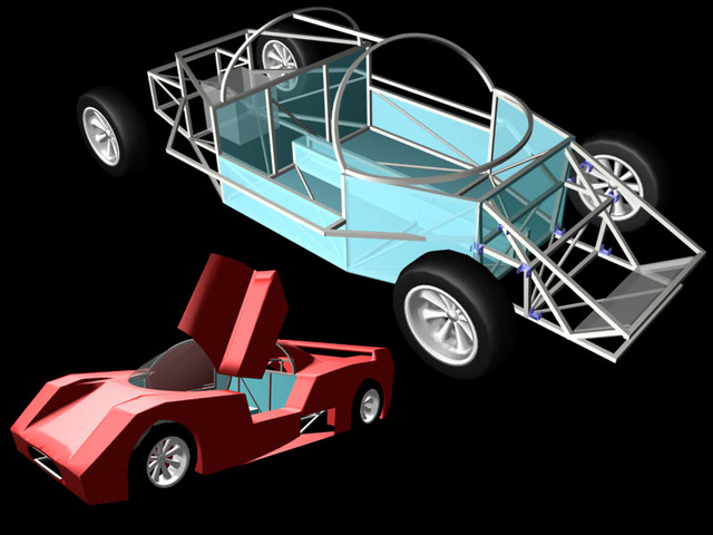

BasOlij
| posted on 12/1/03 at 03:53 PM |
Okay now we are getting somewhere for real. Got the doors in (still need windows) and the frame is somewhat further developed now. Still need to fix
some things at the engine compartment but other then that I think this is pretty much finished.

Bart Vangampelaere
| posted on 12/1/03 at 04:02 PM |
Looks good, but you might find it easier to get in the car with different doors. When you use doors like the 787B or Ultima they'll be less in the
way. These sort of cars aren't easy to get in and out anyway, so you might want to get the best result on that topic.
BasOlij
| posted on 12/1/03 at 04:50 PM |
Hey Bert,
I'm not to afraid of the doors. The way I designed them to open means there are totally clear of the opening.
I haven't completely figured out how to make them stay up, probably some gas struts or something.

cymtriks
| posted on 6/4/03 at 08:33 PM |
I have done a finite element analysis of several car chassis and I would suggest the following for your mid engined design.
The engine bay will need some diagonal braces. Take a look at tube R on the lowcost plans or at the Y brace on the Lotus 23 chassis for ideas. Two
diagonals, one on each side of the engine bay are much better than one.
Don't use that bent tube on the outside of the chassis running from the passenger region to the engine bay. The bend is a bad idea as far as
chassis stiffness is concerned.
The tunnel down the centre of the chassis probably does not contribute much. The lowcost chassis is certainly better if the tunnel tubes are replaced
with a simple sheet steel welded tunnel with minimal internal bracing.
You may be better off, weight for weight, with a ladder frame. The massive superiority assumed for spaceframes is just hype. Most spaceframes are
actually less stiff than a well designed ladder frame due to inadequate triangulation. With additional triangulation and some minor redesign it is
possible to double the stiffness of the lowcost book chassis, reduce the number of tubes and reduce weight aswell.
I have written my analysis results, which cover several types of chassis, into a Word document which I could e-mail to you if you want.
Good luck with building your car.
