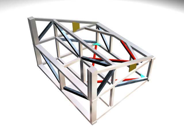

Chris, Great line drawings!
I really appreciate your advice regarding this area. I think you have helped me immensely!
This is my first full ground up frame-up project and I am flying blind in a lot of ways. Anyone else feel that way, or is it just me? I have been
struggling with this bracing thing for a long time. Thinking that I would end up adding a bunch of extra tubes that did nothing and missing a critical
one.
So thanks again. What I will do now is mock up the chassis engine bay in 3DS and upload a rendering for one last lookover.

When I added the bracing around my engine bay on my chassis model it really made a big difference to the overall stiffness of the rear of the car. I
think it is worth the effort and hassle to come up with something in this area even if it has to be bolt in. A lot of chassis seem to neglect this
area and I don't think are very stiff as a result.
I have been following your build steve and the car is looking good. Do you plan on running the car without the bodywork? I am going to do some
extensive testing of mine on the track before I commit to making the buck. I figure its better to discover any fundamental flaws early on when you can
modify the chassis easily.

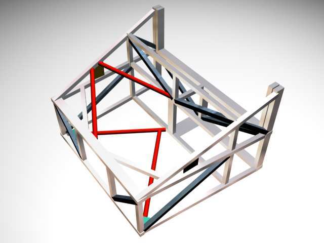

More renderings! Here are a few different renders of what is rapidly becoming a birdcage... The plan is indeed to make the chassis drivable and play
with it like a go-kart for a while. If it handles well, I won't scrap it and buy a Meerkat.

sgraber
| posted on 29/6/03 at 05:50 PM |
Another View...
