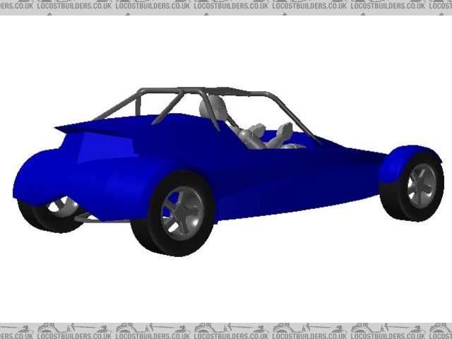

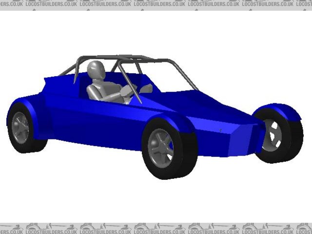

There you go. What you have looks really nice, but the rear isn't as easy to replicate as a Locost rear. If a fiberglass rear cover was
available, great, but I don't think a typical builder will be able to replicate those curves with single bends in aluminum.
What I had in mind is the same old functional Locost rear end. The only difference would be making it just tall enough to clear the drivetrain of
choice.
Don't get me wrong, I think your rendering is far better looking then a Locost, just not easy to accomplish for a typical builder with few
tools.

| posted on 10/9/05 at 01:42 AM |
kb
Is it better now?
  I think I'll build this!...
Messieurs, at your pencils.
JCM
kb58
| posted on 10/9/05 at 02:40 AM |
quote: Originally posted by jcduroc
kb
Is it better now?
Like I'm any kind of expert... with my Bull Dog of a Mini, I guess it takes all kinds!
It's too hard for me to tell from your picture. If we really want to stick to a Locost theme, it mean using Locost fiberglass. That means no
fiberglass for the back of the car, so I'm still not sure what you have in mind. If you (or anyone else) can duplicate that rear end using
single-plane bends, then I think you have a great idea.
We really need to see a 3D picture...

iank
| posted on 11/9/05 at 07:54 AM |
Looks nice from the side view.
One nit, I think the roll bar needs to be higher, or there isn't much point having one.
From memory it's supposed to be at least 3inches higher than the top of the helmet for motorsport, but someone with a blue book in front of them
will be able to say for sure.
jcduroc
| posted on 11/9/05 at 10:03 PM |
This is just a sketch of what a Locost-inspired-Middy could be.
I had no worries about the details that (as for the Locost 7) anyone can change.
JCM

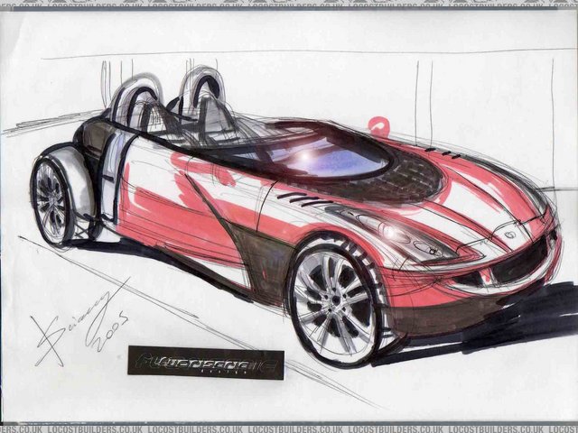

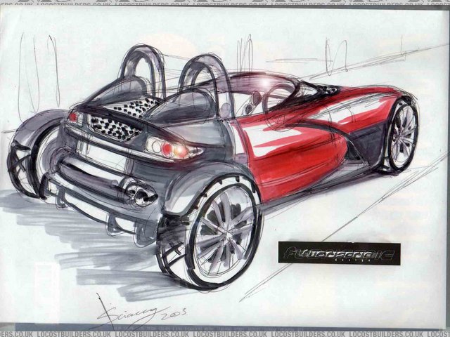

FUORISERIE
| posted on 13/10/05 at 01:42 PM |
I've been playing around with the same idea of a modern econimical middy, these are some of my very rough sketches, what do you think.
FUORISERIE
| posted on 13/10/05 at 01:44 PM |
other
kb58
| posted on 13/10/05 at 01:58 PM |
A nice-looking concept, but not very "Locost". Are you planning to make the bucks, molds, and sell composite panel sets for, oh, $1500?

It actually looks like a cross between a toyota celica and steve's la bala
FUORISERIE
| posted on 14/10/05 at 09:33 AM |
Actually these are some of the preliminary sketches for a finished rendering I've been working in the last few weeks.
There is a more basic and locost version of this sketch that I will try to post, for you guys to comment on.
It will have less bodywork on the sides and it will be a step-in kit. I'll show it soon

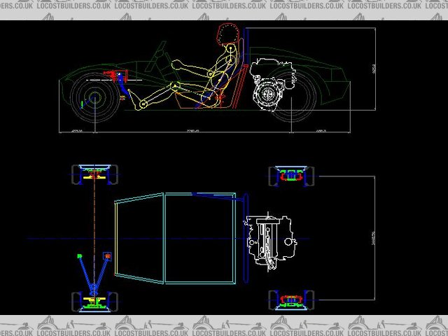

| posted on 24/11/05 at 07:28 PM |
is that 50x50mm for the chassis. It looks like a ladderframe which will need some thinking about to make as strong as a spaceframe (for example I
think the cruciform section in the floor should be an X rather than a + to prevent twist if you see what I mean).
Look at the stuff JC has been doing, quite similar layout. Search on here, or go to his blog http://www.mistrale.blogspot.com/
[Edited on 25/11/05 by iank]
cymtriks
| posted on 24/11/05 at 09:15 PM |
Byronjet,
Did you by any chance copy a Stratos replica chassis?
The centre section needs stiffening up. I would suggest using sheet steel sills, say 2 inch x 8 inch in 16g. Check out my photos section for a scaned
in idea called something like middychassis.
The chassis I posted earlier in this thread has been run through FEA to get a feel for stiffness, it's roughly twice the "book"
chassis stiffness. You could just copy it!
