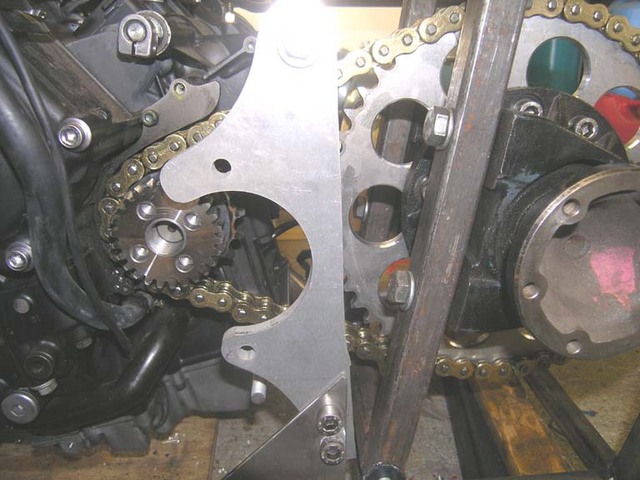

lsdweb
| posted on 25/11/08 at 09:03 PM |
Mine during fabrication

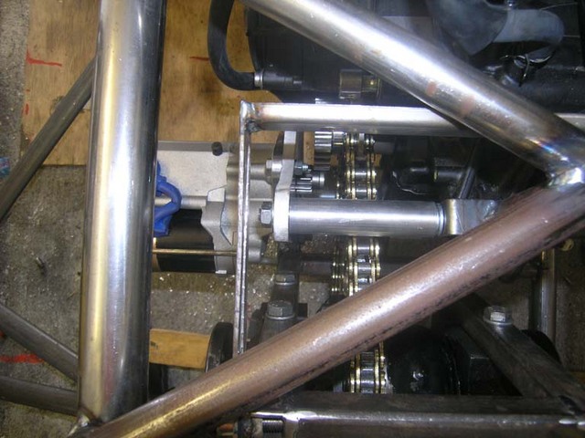

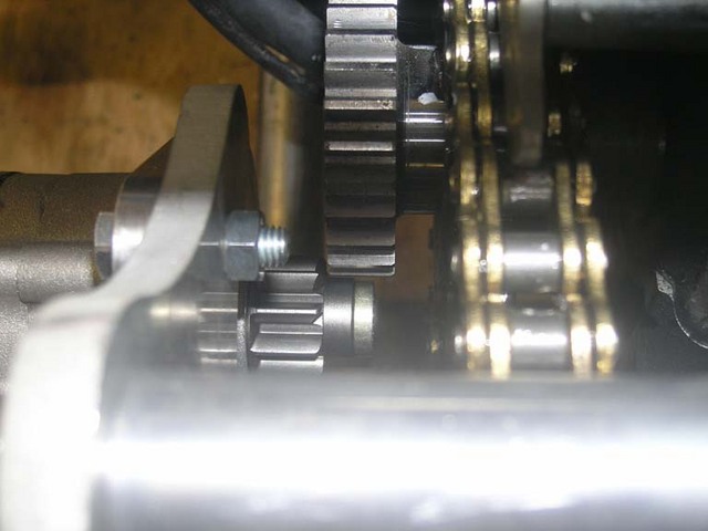

nitram38
| posted on 25/11/08 at 09:08 PM |
Mine:
Complete with reverse:

| posted on 25/11/08 at 10:53 PM |
There's a couple of mine in my photo archive showing the reverse gear setup
