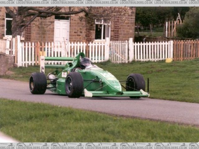

Terrapin_racing
| posted on 18/2/04 at 10:57 AM |
A picture of a two seater Terrapin in action (not that good a quality though)

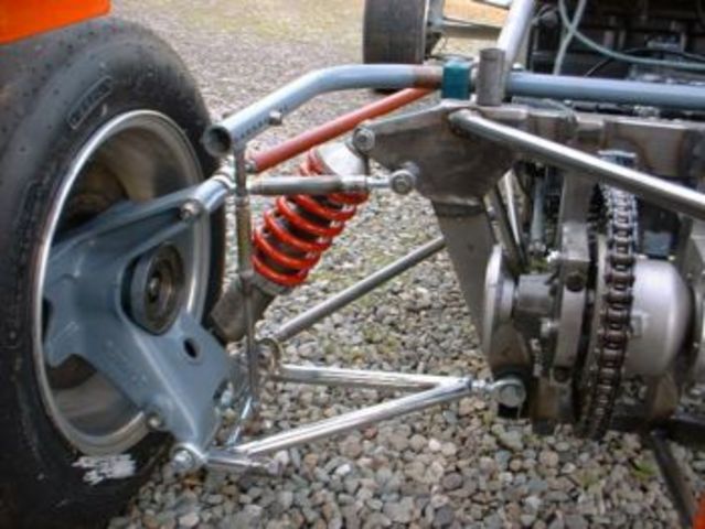

Terrapin_racing
| posted on 18/2/04 at 03:16 PM |
Bike engine - drive
Costly way is to contact Quaife and buy a tranfer box - megabucks
or
most races/hillclimbers adapt a mini/maxi/allegro/montego diff unit to chain drive. There's a company that machines the chainwheels off a bike to
bolt onto the diff unit. Two bearing support blocks are then used to hold the diff.
Just looking for a piccy for you....

kb58
| posted on 18/2/04 at 06:26 PM |
Referring to the above photo of the suspension, I'm glad to see someone else has the lower shock mount directly on the upright. I designed mine
that way, but have worried about it ever since... because I'd never seen it done elsewhere.
