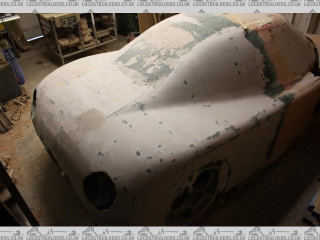

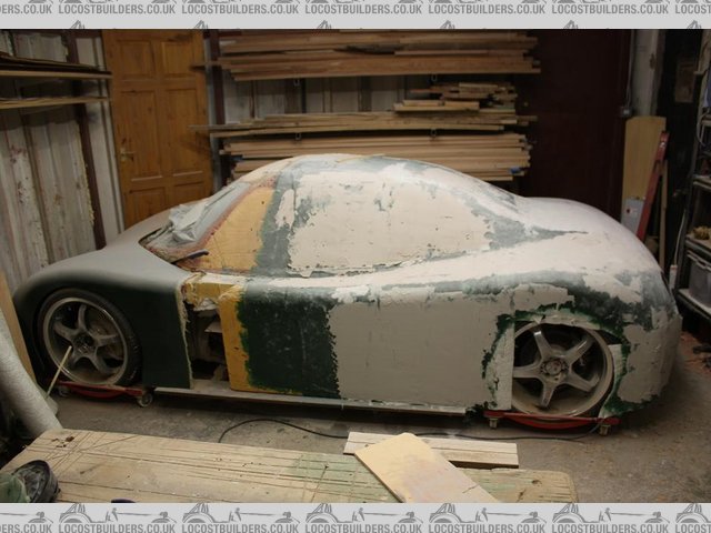

had a good weekend at it in this case so here is what ive got done-
managed to get the rear end shaped in the foam over rthe last couple of weeks then satdy morning gave it a couple of coats of PVA then fiberglassed
over the whole thing-
  rear glassed over
then proceeded to fill out all the imperfections, have given the whole thing a rough fil then concentrated on the right quarter which is now just
about done-
  smoothing rear
  rear right quarter nearly done
so there you go, now ive got the fiberglass on i can do bits and bobs until its smooth all round.

I was wondering when you were going to get around to the back, because the front is pretty nice looking.
And it's definitely a one off - and all the better for it IMHO.

Looking good Russ, do you also find you have to be carefull to not dig a "ditch" when trying to blend a relatively tight negative radius,
as in where the glass house blends into the tops of the wings?

ah, i see. thought id messed the pics up or summat. yeah that what i always say when people ask what its like. koenigsegg is pretty close, its the
windscreen mainly.
yes fred, just need to be patient and not be tempted to sand out all the pinholes on first fill as youll go too deep, takes a good 3-4 layers to get
it perfect.

Doug68
| posted on 22/6/09 at 06:50 AM |
That's look great! It gives me some confidence that the shapes I'm working on for my car won't look daft in real life.
Stupid question: I know PVA as white wood glue. What's being referred too in this case?
Thanks,
basicly the same stuff, just the lowest grade as sold in the building section of b&q in 5l bottles. thin it down a bit with water and paint it on,
2 coats.
its only really necessary on the crushable type foam polyether something i think) as it reacts with resin. the spongy stuff is probably polyuerethane
so should be ok, infact it takes an age for pva to go off on PU so best to leave it anyway. but as always test a small area first with resin to make
sure.
