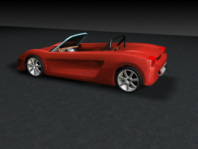

It was a very good day in the Graber 3D cave! I spent about 8 hours straight in 3DS MAX working on the rear of my car, and also reworking the side a
bit. I am happy with the result.
The tail lights are Jeep Liberty - turned sideways. Looks a lot like the Enzo! Which I like.
The images I have uploaded are not 'quite' finished, but close enough to show you guys!
More renderings here in the Gallery: http://inflow1.websaverlive.com/traycomm/gallery/balarear

Yes Steve, you are right those lights do work......IMO it is probably the nicest feature of the Enzo..

Hey, Steve, that's very slick Really coming together, and definitely works!

I forgot to mention that I think it looks good. Nice idea on the taillights.
Will the exhaust system really be exposed like that?

Hi Winston,
The bottom edge of the rear bumper is not finished in those preliminary renderings. There will be an oval cut-out on the right side of the car where
the 2 exhaust cans will exit. They should not protrude much. You will be able to see a hint of the cans from the rear, but not the toilet paper rolls
that appear there now!

That top down image looks awefully familiar!
I wonder where you got the inspiration?
A certain Meerkat perhaps?

Interesting you should say that. It wasn't done that way on purpose, but now that you mention it, the center section does bear a remblance.
The decklid needs a bump to clear the intake manifold of the 4AGE. It made sense to extend it forward to the passenger compartment and to mirror it
across the other side for symmetry.
BTW - When you see the rear you will say that it bears a resemblance to any number of Ferrari's, from the side people say it bears a passing
resemblance to Lamborghini... DNA from many cars I admire.

Coming along nicely steve. IMO there's something not quite right about the back 1/3rd side profile. Can't quite put my finger on it.
Maybe its too flat. Have you thought about giving it some hips or maybe waisting it in slightly in the middle. Anyway, keep up the good work.

Looking good. I'll second what LMP says about the rear side profile. I think the rear looks "underwheeled". I'd try adding a
wheelarch lip, similar to what you've done at the front, or lowering the hip slightly, or a combination of both.

I definitely see what you are saying. I can see how making the back fender have a bulge would add some tension to that area and make it look more
muscular. Now the difficult part. Modifying the patch. (Nurbs)

Here's my suggestion for breaking up the expansive surface over the rear wheel. I added Bertone's signature rear wheel arch, a rock
gaurd, and a "character gash" that washes out towards the tail lights. Just throwin' out ideas!

I see where your going with the Bertone thing Jim. I'm just not sure if it's my cup o'tea. I of course really like that you took the
time to work out a solution.
I have some ideas for improcing the rear flank that involve thinning the waist-line of the car into the cockpit so I can get a more waspish curve to
the rear fenders. I just don't have the time to work on it till next weekend.

This is what I had in mind. Rear wheelarch lip and lowered hip.
Your car has a long wheelbase, so I've also lengthened the side vent to remove some of the "fat" between it and the wheelarch. If the
result of this makes the car look too long and skinny in full profile view, you could try starting the side vent back a little from the front
wheel.

Yes Geoff, that's close to what I have in mind for the rear wheel arch. It may not be so sharp edged, but something like that, that then pulls
inward to create a muscle bulge for the wheel.
Nice, thanks.\
