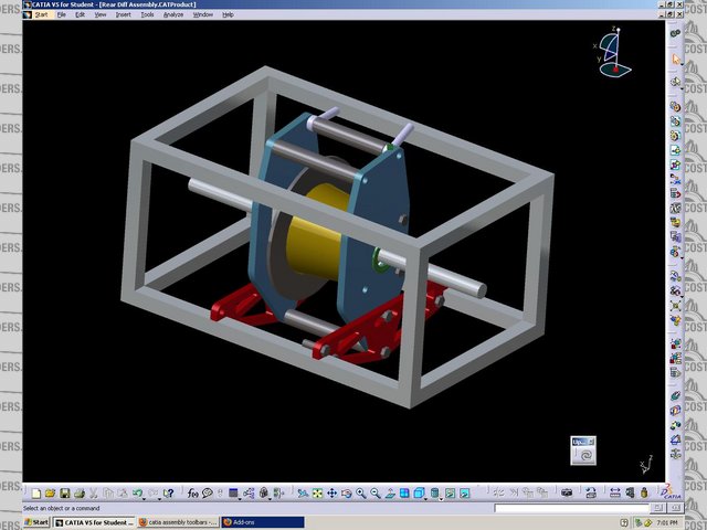

And here is my latest task... building a chain driven differential utilizing a 2008 Mazda RX8 Torsen differential and Mazda RX7 half shafts. The
differential will be supported by large self aligning pillow block bearings, the outer end of the plates will be sealed with pressed in (machined area
cut out) round axle seals, and the differential will be sealed to make one completely sealed assembly.
I am very much considering welding mounting points to the CV outer tripods and using a set of 2004 Yamaha R6 front rotors and calipers as inboard
brakes.
