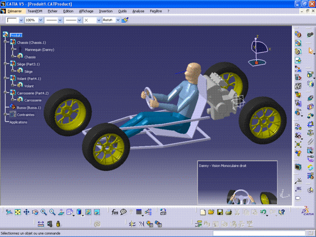

Got the Catia training last week so my project realy starts now.
The guy on the screenshot: It's me!!!

Looking good!
Out of interest, from the driver's-eye-view it looks as if he is positioned off centre, why have you done this? From what I can see it looks
like a single seater, so woldn't you be better off in the middle?
Pete
It's not that I'm lazy, it's that I just don't care...
stevebubs
| posted on 5/11/04 at 01:20 PM |
Looking at it, it looks more like a 2 seater, but only has the floor and 1 upper chassis rail modelled.
Be interested to see the final version...
Aloupol
| posted on 5/11/04 at 10:26 PM |
Me too
Yes it's the early early early start but it's a two seater.
I'd like to make a full body with doors and roof but it will be hard for me to design a pretty outline. Maybe I can find someone to make a clay
model, will see.
If not I will make something more simple as in my pics archive. (7 style a bit like the R1ot).
Question: is it important to keep the pedal box in the center line of the seat? Some cars have slanted driver position, as the Alpine A110 but I
didn't sit in such a car, I don't know if it's a problem.
Spyderman
| posted on 7/11/04 at 03:17 PM |
There are a few cars that have the pedal assembly off-centre to the drivers seat. Although strange at first it is something that you quickly become
acustomed to and don't even notice if not too much out.
Altering the angle of the driving seat in order to align them would cause more discomfort in the long run as you would need one arm longer than the
other in order to hold the steering wheel evenly.
The seat should always be aligned with the steering wheel if at all posible.

| posted on 14/11/04 at 09:53 PM |
Thanks a lot. I will use the reverse approach: place the pedal box where it fits well, and then the seat in its center line. So the driver's
seat will be ofset inboardwise and there will be less room for the passenger seat.
Girlfriend 60 kg maximum...
