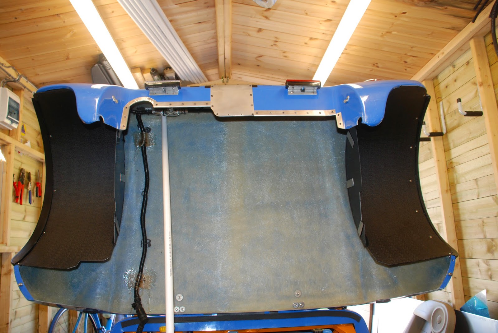

rear wheel arch covers for mid engined cars...J15
It may (or may not) be of interest, but having been scratching my head about how to protect the engine bay from road grime kicked up by the rear
wheels, I finally settled on making up some inner arch sections that are contained within the rear clam. Now it's finished, it seems to work
well, and at least keeps the worst of the crap off.....Anyway, pics in the latest blog update as I can't seem to post jpg pics any more on this
web site!.

Looks good! Might have to do something like that to my Mojo...

saw this on your blog the other day. I will probably copy the idea in some way to keep my rear end (ecu, engine etc...) clean and grime free, although
ill put them in after the test.

Looks good Jenko and very apropos as I'm looking at exactly this question for my middy build right now. What sort of plastic is it - ABS? And
what thickness - looks like about 3mm-4mm?

It's 2.5mm ABS pinseal...if you look on eBay its about a tenna for a large sheet...I bought 5 sheets some time ago.
