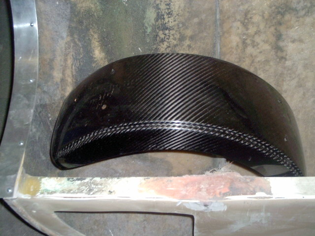

smudgersmb
| posted on 31/12/04 at 03:13 PM |
Cycle wings in CF showing weave (poor pic)
Cita
| posted on 31/12/04 at 05:04 PM |
Very nice looking wings indeed!
