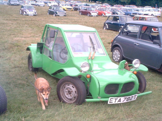

Whilst I agree with some points, I think mid-engined is a lot of fun, I have the best of both worlds, fantastic steering due to Mini rack etc and
power/weight on the rear wheels giving me better traction.
Proud Mosquito Owner (1 of 10)
Smudger
