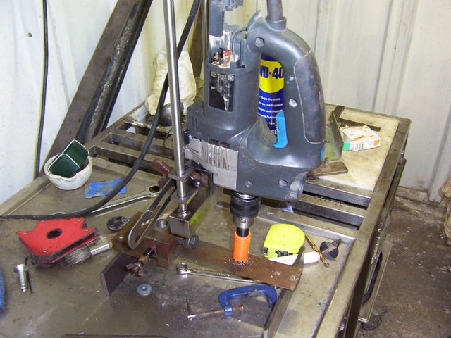

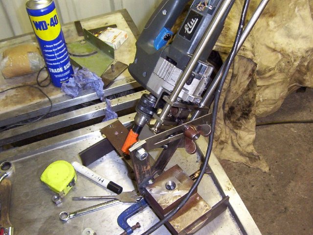

not sure if this is exactly what you ahd in mind joel-
  god of all notchers
  mmmm, adjustable
just about finished it today, just needs some vee thingies making for the tube to sit in and some sort of clamp. i will probably use one of those
clamping pliers you can get with the bolt on the bottom for using on pillar drills etc.
i admit it is waaaay over the top, but it was fun to make and made use of some of the bits of steel i had laying around, and the old nackard jigsaw.

Rorty
| posted on 28/8/05 at 09:13 PM |
Russ, surely a drill press would do all that your machine does plus a whole lot more?
How do you support the tube during cutting to prevent it dancing around and tearing the teeth out of the holesaw?
I admire any person who builds a contraption that works.
