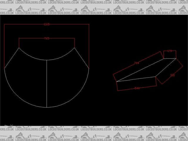

suparuss
| posted on 29/9/05 at 05:12 PM |
thought these 2 pics might help with the stratos screen-
  stratos blue print

geoffreyh
| posted on 29/9/05 at 09:20 PM |
I've been checking this out and it is a really nice solution indeed.
I don't know what is costs but the complete window/glass set is available for £395 or $593 ( http://www.tornadosportscars.com )
I was told the Stratos replica windshield is about £350
I will probably design with both solutions and see what's the best.
Geoff
