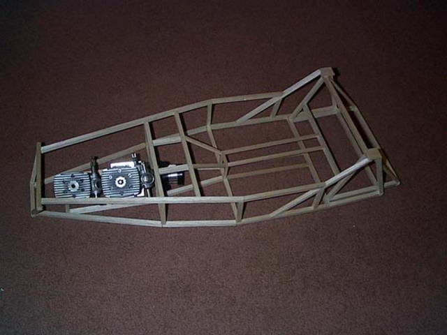

Anyway, I promised a picture of my feeble attempt at a model standard chassis, so here it is complete with twin bike engine installation . There's
still more to be done, but why spend time making models when I can spend that time building a real one? I expect it will get finished on a day when
the garage is particularly cold, dark and uninviting. Incidentaly, although you can't really see it the front engine is bearing witness to what
happens when you run out of power 3/4 through a loop and the heli ploughs into the ground on one skid. Some fins broke off the top, and despite the
assurances of my club mates, subsequently caused the engine to heat unequally, ovalising the cylinder liner and scoring it, the piston and the piston
ring. One £100+ engine consigned to the bin, or use as a paper weight/trinket as it currently is.
Just for some fun facts and figures the front engine revs to 20000rpm, runs on methanol and nitromethane and produces approx 225 BHP/litre naturally
aspiring!!

The model looks good you should finish it.
