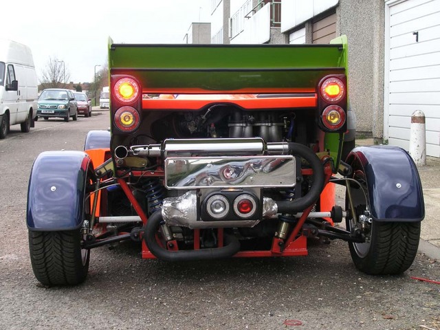

| posted on 22/1/07 at 10:13 PM |
More bones
Raz
