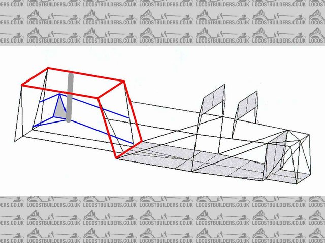

| posted on 24/8/03 at 08:10 AM |
chassis for middy
I have been meaning to post this for a while but haven't had time. This is my design for a mid engined seven chassis. Stiffness about double the
book chassis. The red beams are 2x4 14g section wich makes the engine bay wide and stiff with easy access. Most space frame chassis have rather floppy
engine bays. The two arches at the scuttle are my attempt to make the dash ect structural. The blue bits are a wishbone arrangement and the vertical
grey part is supposed to represent a spring. Hope you find this interesting.
