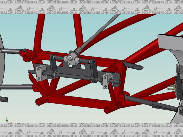

My steering
Thought I'd share my steering idea...
Basically I wanted a custom rack, but was not prepared to pay the high costs so I thought I'd start with a low cost rack and make cheap
mods...that's the theory at least.
Instead of lengthening the rack directly, I'm using the rack to drive a lower shaft in parallel..
Hopefully the pics should tell the story..
  Steering concept
  steering 01
[img][/img]

| posted on 30/7/07 at 11:52 PM |
why not just lengthen the rack directly?

Alan B
| posted on 31/7/07 at 12:17 AM |
Good questions, thanks....
I thought of extending it directly, but that would have needed two extension shafts (Ok, easy) but also two extension pieces for the rack housing
which would have be pretty accurate both dimensionally and concentrically for it to be smooth acting...and then find a good way of joining and sealing
it and still be rigid......It would almost be easier to replace the housing.
Doing it this way I also get the steering column higher up, away from my feet on the pedals.
No dog leg needed...it's central seating for the driver ala Mac F1...
[Edited on 31/7/07 by Alan B]
bpgoa
| posted on 31/7/07 at 12:20 AM |
why bother extending the outers.. just run it through an outboard bush...
and the dog leg question was in case you crashed,,, you don't want the steering wheel becoming too good a friend!!!
On and On the River flows... We the Undertow
bpgoa
| posted on 31/7/07 at 12:26 AM |
food for thought...
drop your rack below the top chassis rail, add extensions, then run them though bushes (reamed - easy) mounted in the pillow blocks..
that way you get the dog leg (so that the column folds if you crash) you drop the weight lower in the car.. remove excess engineering you can get
your rack parallel to the bottom wishbone..
however ... I'm not an engineer... just a keen beginer...
[Edited on 31/7/07 by bpgoa]
Alan B
| posted on 31/7/07 at 12:33 AM |
Good points again....I probably should have posted the idea before starting it...LOL
Re dog leg...Ok I get what you mean...I was thinking of a wire mesh type of collapsible column.....
Again, your feedback is appreciated...

BenB
| posted on 31/7/07 at 11:38 AM |
When the steering column runs directly between your legs it's even more important to have a dog leg in case of impact.....
Otherwise
Worst case- Ayrton Senna #2
Best case- Singing like Jimmy Sommerville
BenB
| posted on 31/7/07 at 11:42 AM |
But then I'd be exceedingly wary of doing anything too DIY with regards to steering.....
After all, a wheel falls off, you can probably struggle to a stop.... the engine fails, you've still got steering and brakes, one side of the
braking circuit fails you've got the other side of the handbrake (or engine braking)....
the steering fails... say hello to Mr Armco and his good friend Mr Local Casualty Department....

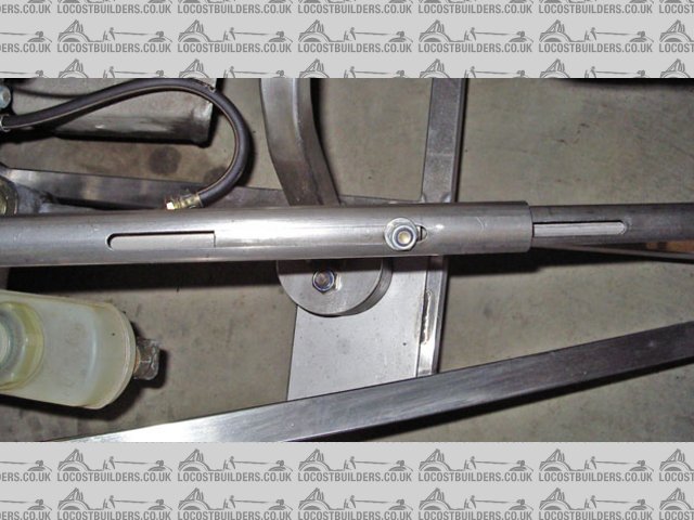

I realise your car is not subject to SVA but there is a alternative way to the mandatory dog leg, that being, a telescopic section.
As I understand the SVA regs the wire type upper section is to lessen injury should the driver be thrown forward towards the dash.
This is as well as a collapsible telescopic section OR dog leg of 11deg or more in the lower shaft.
As I have 9.5deg offset in my own build in the lower shaft I have made my version using two tubes that have slots milled in them,
and a boss inside with a protruding stud to act as a clamp. (see pic)
It may be easier to do a similar thing in your case, rather than a dog leg.
Just a thought.

Ah good idea Paul.....so you're saying if you have a telescoping section and a mesh type collapsing section you should be OK without a dog leg
or angle change?
Also, how much travel of telescoping do you have?...it looks like about 3" or so....is it nipped up pretty tight, or not?

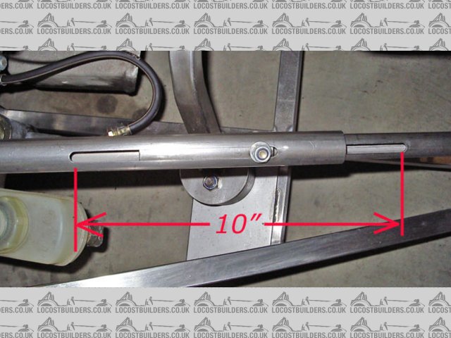

| posted on 31/7/07 at 11:05 PM |
Hi Alan
I'm sure they give a figure of 127mm ( 5" ) but as it is fitted I have 10"

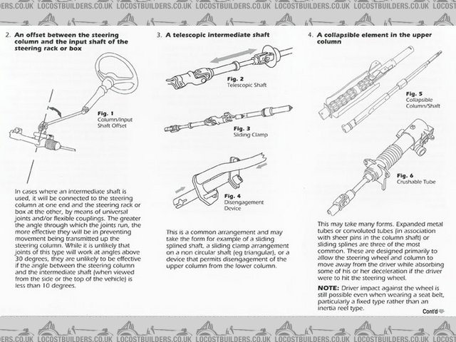

I'll also post the page from the SVA manual. Sorry it may be a tad big.

907
| posted on 31/7/07 at 11:07 PM |
From the manual

the only problem i would see is that you are introducing other components into the steering function that are liable to wear out / fail over time.
if you lengthen the arms and connect them directly to the hubs then they are the only component doing the steering.
i can see as a design it would work but i like to keep things simple with less components to go out of alignment or wear out.
As someone else said tohugh it is easy to analize someone elses design than come up with one of your own.
just my thoughts.

Hi Paul,
Glad you had a good time and enjoyed the Shack..
First of all utimately I will make my own decision on the steering design, as we all would. However, it's not say that everyones opinion is not
valued...trust me it really is and I'm quite torn on this one.
Bpgoa said....
"drop your rack below the top chassis rail, add extensions, then run them though bushes (reamed - easy) mounted in the pillow blocks..
Which I think is a simple and obvious answer.
However, my point against this is the fact that the original rack bar is tapped 3/8-24 at the end and would easily extend with studs and extension
pieces, however they would be relatively long (about 7.5" each) compared the rack bar length of about 9" and without very long outboard
bearings (which aren't possible without losing travel) I'm concerned about the buckling stabilty of the whole assembly....kind of scared
of it buckling at the knees so to speak.
At least with my version I have a full length solid bar that is attached by two robust arms to the existing rack ends.
Paul, about your point re: wear and tear, the only extra wearing parts are the two outboard bearing blocks which would be used on the simpler version
anyway.
Saying all that, the simpler version is course...well simpler...and a little lighter not using the side arms.
So quite honestly, you all have made me re-think my solution...I know I don't have to convince anyone but myself...I'm totally convinced
that it's safe and reliable......but is it the best solution....??
Who knows...we'll have to wait and see..
Again thanks all......

| posted on 5/8/07 at 12:04 PM |
Hi Alan,
mmmmm, tricky one!
I personally would not be keen on doing it with the parallel bar. The bending loads on the two legs that connect the rack to the slide bar will be
pretty unpleasant, and the loads they impart on the rack ends will also be quite nasty.
What lengths of steering arm do you need? I assume its not possible to just use very long steering arms!?
If it does need extending (which it obviously does for you to be going to this trouble! ) then I would say that screwed in rack extensions would be
fine, made from the same diameter bar as the rack itself and staked or high strength loctited into place
