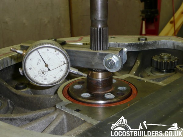

First remove the flywheel and make sure the gearbox mounting holes have plenty clearance to allow you to adjust the alignment. Make up a bracket to
hold the dial gauge as shown in my photo archive under crank nose (how do you do that linky thing????)
Note the photo shows the spigot bearing in place just to support the dummy first motion shaft for the photo ‘cos I can’t gets the camera in when the
bellhousing is in place. You do not want the spigot bearing in place for these measurements or the result will be, as they say in Glasgow, mince. This
may be a good time to mention that the spigot bearing has to be extended by the thickness of the adaptor plate to support the first motion shaft. In
this instance it is slightly less ‘cos I was fitting a twin plate clutch. This required extra clearance anyhow.

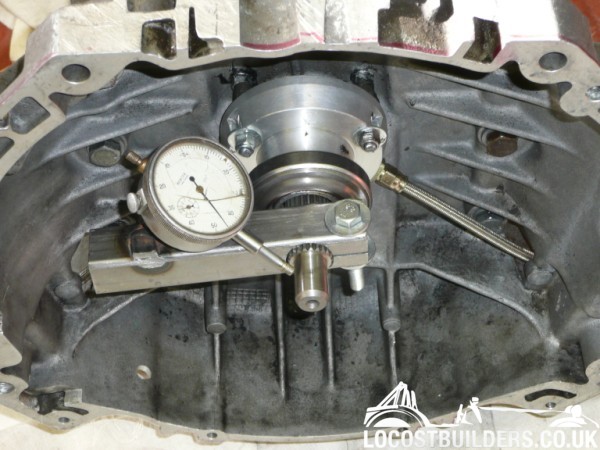

Back to the dial gauge. It has to bear on the crank nose not the spigot bearing ‘cos they might not be absolutely concentric.
Look at the picture in my archive – dial gauge on input shaft – (I need to know how to do that linky thing!!!) to see how it will look just before you
assemble the box to the engine.
Careful when mating them as you could trap the dial gauge – I used a bit of thin cardboard as a ramp to ease the nose of the dial gauge over the crank
nose.
From now on it’s easy peasy. Rotate the first motion shaft through four positions 90 degrees apart and adjust the alignment until there is no, or as
near as no variation in the dial gauge reading.
Watch out for parallax. There are a limited number of openings in the bellhousing to observe the dial gauge and if observing from an acute or oblique
angle it is easy to misread it. I drilled 12mm holes in the bellhousing opposite my reading points so I was reading it square on.
